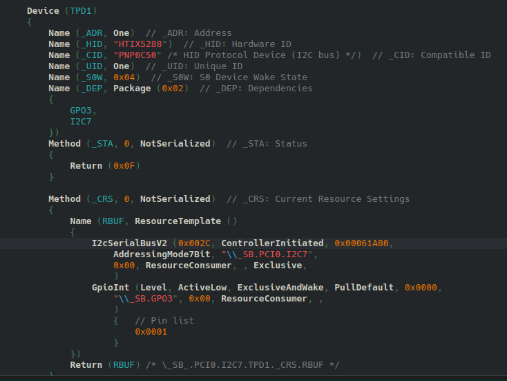

From what I have found, the method used to set the i2c speed at 400Khz is based on a device entry in the ACPI table. I pulled the running ACPI table and decompiled it with iasl and found the device on I2C7:
0x00061A80 is 400khz. From what I understand the Intel controller will limit the bus speed to the lowest device on the bus. So by putting the entry for that touch pad in the ACPI table it effectively sets it to 400Khz. I need to change that to 0x000186A0 or 100Khz, the problem is I can’t find a way to do it. Ive tried several methods of ACPI override on Manjaro and none of them stick, it always falls back to this ACPI table. I could change it in the BIOS update image that is distributed but I can’t find it in the image with UEFItool.
