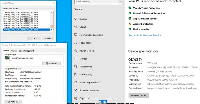

I have one set up on my desk with LG 4K display. the ODYSSEY works well with it on 4K 60Hz.
here is the screenshot on windows10, you can check the full picture in a new browser window.
if you still have the problem, I hope someone in Seeedstudio could share more info.
Hello Kevin and thank You for answering !
I have spent again many hours today it never runs at 4k 60 Hz (also have same monitor as You as well as 2 OLED 4K screens) tried newest Intel UHD graphics driver etc. Also tried setting onboard VGA memory in the BIOS to 512 MB nothing helps fix the problem.
Did You install Windows Yourself or the one that came pre installed on the eMMC flash ?
Do You know if perhaps there is a newer BIOS for the board somewhere ?
Thank You !
