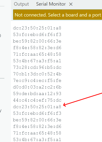

On another note, i was digging around in the code to see what filters it uses. As i’m pretty sure it does receive the sensor, but it gets filtered for some reason.
This led me to set #define BLE_TRACE; However I get no trace. What am I missing?
Well I was right. Issue itself is not fixed yet, but I now know where it’s going wrong.

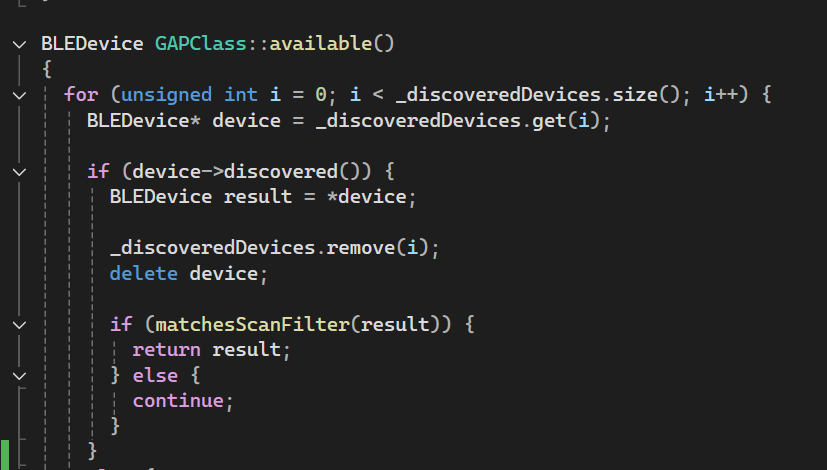

So the XIAO DOES see the device. The offending code is here:
The issue is that my device/address doesnt make device->discovered() evaluate to true.
… will update when more info avail.
It appears to me Tuya is not following the bluetooth standards on this one. The advertised data frame is decoded incorrectly, resulting in the flags set to 1, whereas the code expects either 0x03 or 0x04 to be set. For now I solved this by changing the flag mask from 0x18 to 0x19.

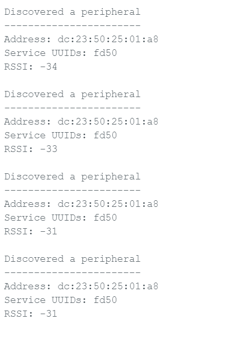

Its starting to look more and more like I’m right in this:
Looking for UUID FD50 yields:
" ya’s pairing protocol also includes the Tuya-specific service (UUID: 0xFD50 ). This service defines properties (read, write, and notify) for characteristic values and specifies Bluetooth LE parameters such as advertising period/interval, connection interval/mode, and data exchange method to maximize Bluetooth performance."
In other words… i’m fighting tuya specific crap.
