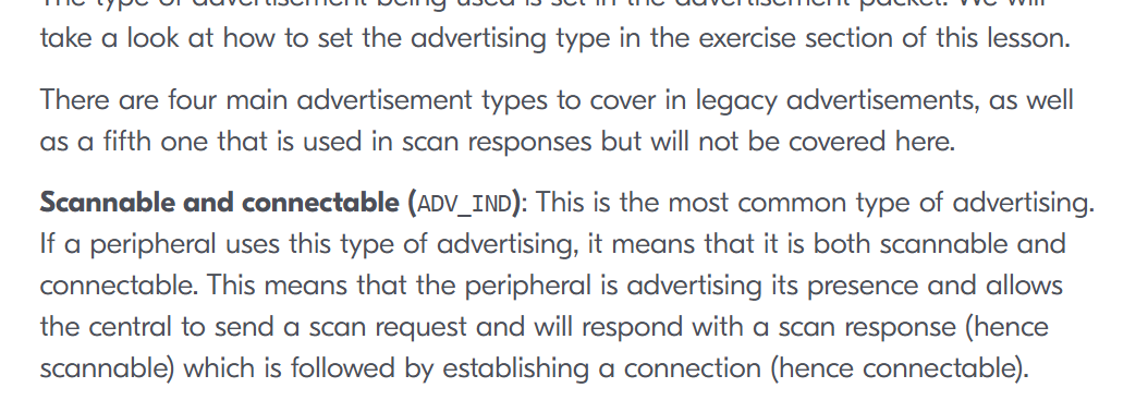

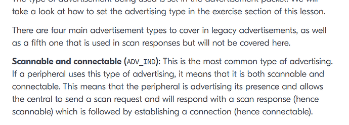

To demonstrate how useless you are… I checked. And as the nordic docs say, legacy is pretty normal and has 4 modes. Nordic. You know, the maker of the chip in the XIAO NRF52840 that I use.
Also, most if not all devices in nrfConnect say to be of scanning type legacy, but ARE visible to the XIAO.
In other words: you are hungup on something not relevant. Again.

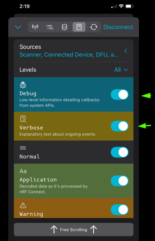

Regarding nrF Connect for Android… There is a drop down menu to the top right with a “Show Log” menu item.
Then at the bottom left of the screen is a drop down with a “Verbose” option. There’s also “copy, share and save” buttons.
You should be able to use those settings and buttons.
You are right!
That yielded this:
