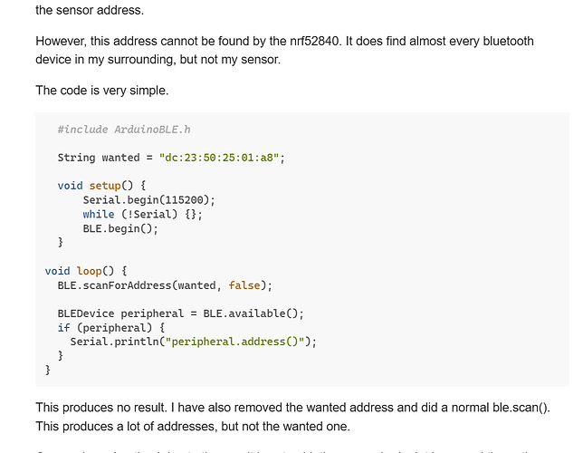

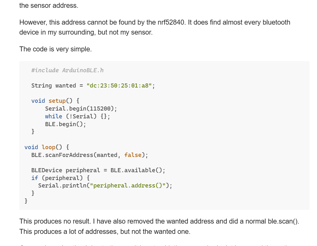

The code is very simple.
  #include ArduinoBLE.h
  String wanted = "dc:23:50:25:01:a8";
  void setup() {
      Serial.begin(115200);
      while (!Serial) {};
      BLE.begin();
void loop() {
  BLE.scanForAddress(wanted, false);
  BLEDevice peripheral = BLE.available();
  if (peripheral) {
    Serial.println("peripheral.address()");
This produces no result. I have also removed the wanted address and did a normal ble.scan(). This produces a lot of addresses, but not the wanted one.

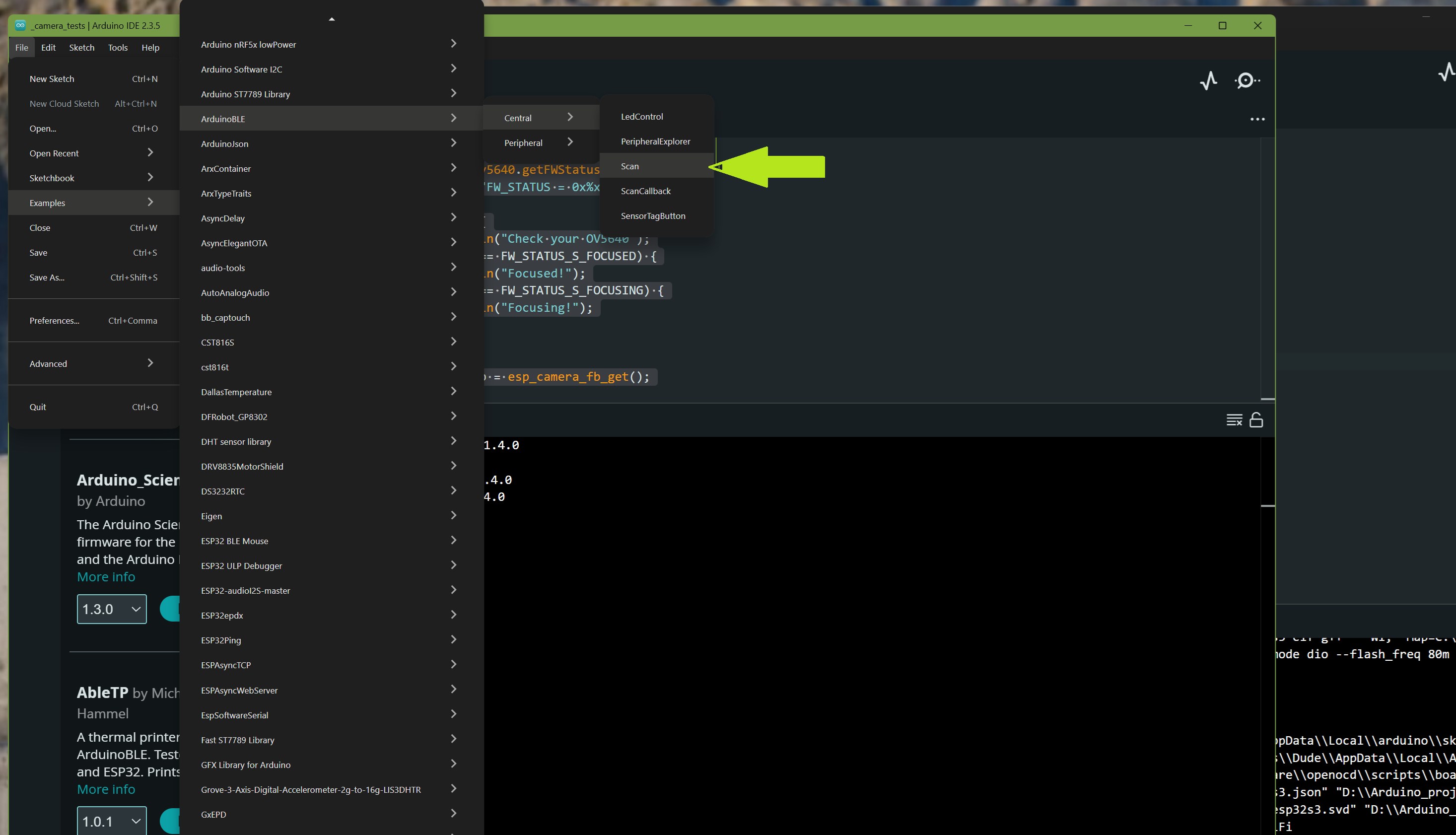

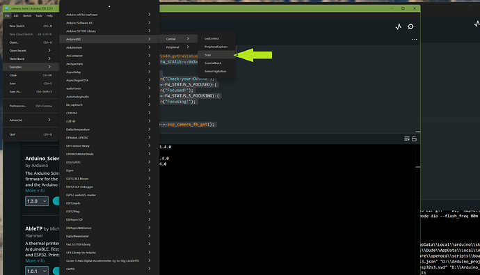

Can you load this example and run it?

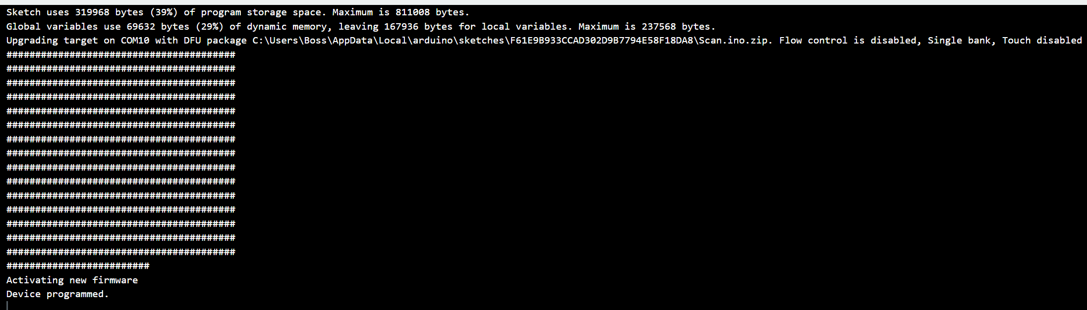

Output:
Runs fine, as it’s basically the same code. Produces the same addresses, but not the address of te device I’m looking for.

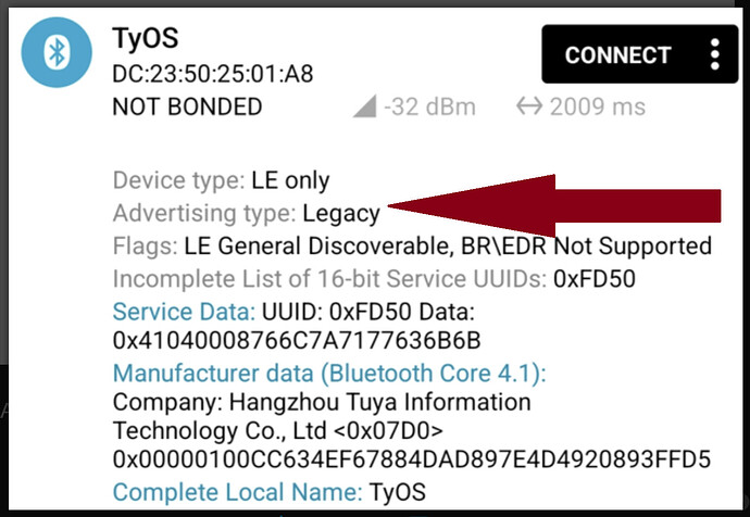

Appears you do have what should work? The Tuya could be classic BT in which case you can try the NON-mbed BSP’s like 1.1.1 and the BlueFruit (bluetooth) LIB , open the basic scan example and see if it shows it’s colors. Can you show how it looks (what service it advertises) Picture from the nrf_connect mobile app?

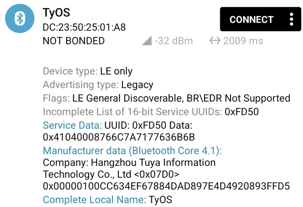

The device type is LE only, advertising type legacy.
LE General discoverable BR/EDR not supported

The device is a bluetooth LE device, as described in the opening post.

Did you also see the: device type: LE only above it?
