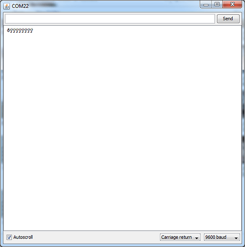

What is happening is that I am not getting any data from it. Usually it will send those initial random characters, the startup sequence and then Call Ready. But now all I get are the random characters.

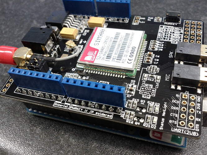

please sent the result and hardware installation photo here, and IDE you are using .
I swap between an Uno and a Duemilanove but both give me the exact same result.
I am using the Arduino IDE, 1.0.1.
I attached the images.
