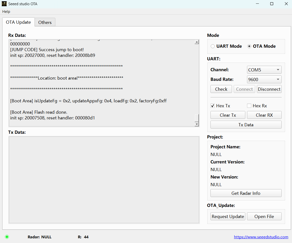

I programmed the radar firmware first with MR60FDA2_eeprom_v4.0.18.bin and then with MR60BHA2_eeprom_1.6.4.bin. Now it keeps sending on the OTA upgrade tool the information on my screenshot but doesn’t go in to update mode to receive a new firmware.

OK, so what do I do now? The hardware is not damaged, it sends regularly information (as seen in my screenshot above), but I can’t “Request Update” anymore.

I did the same thing as @umaiku1, but I believe I did it in the opposite direction (flashed MR60FDA2 on MR60BHA2 hardware.) I am seeing the same behavior in Seeed OTA as @umaiku1 .

I use MR60BHA2 and updated by the correct latest firmware (MR60BHA2_eeprom_1.6.12.bin) from the web page seeedstudio and after finished update my module stuck in the exact same state. I cant work with radar and it is stuck in the bootloader. Therefore I think there is not only problem with different firmwares.
