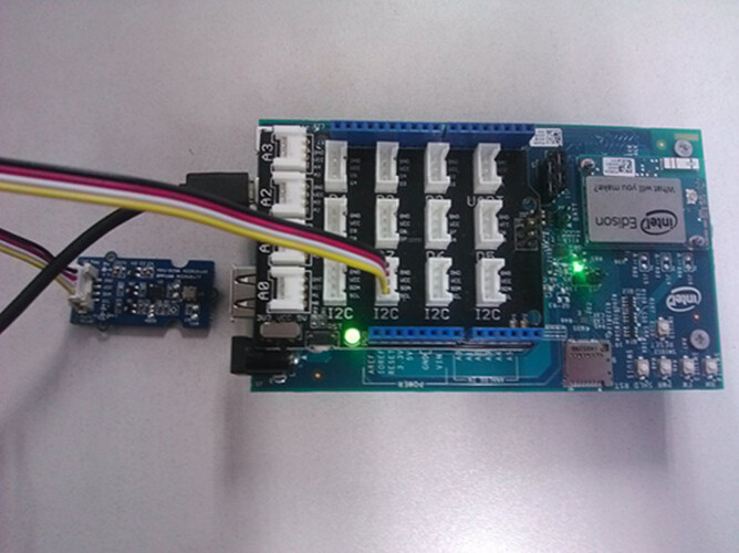

The hardware connection is as the picture shows:

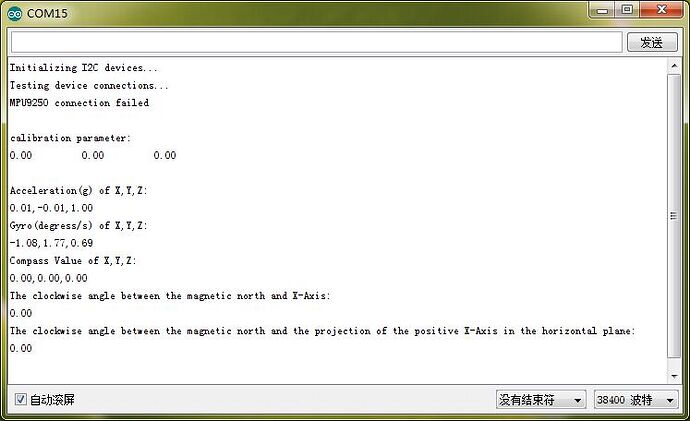

The result is as follows:
In addition,the data did’t update.

Hello,
Sorry for the delayed reply.
This example works perfectly with Seeeduino/Arduino.
The technical team confirmed that the issue you are facing is due to I2C hardware problem with the Edison board and it cannot be solved by software.
