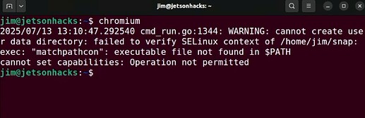

When you tried to launch the application with in terminal, you might see the error below:

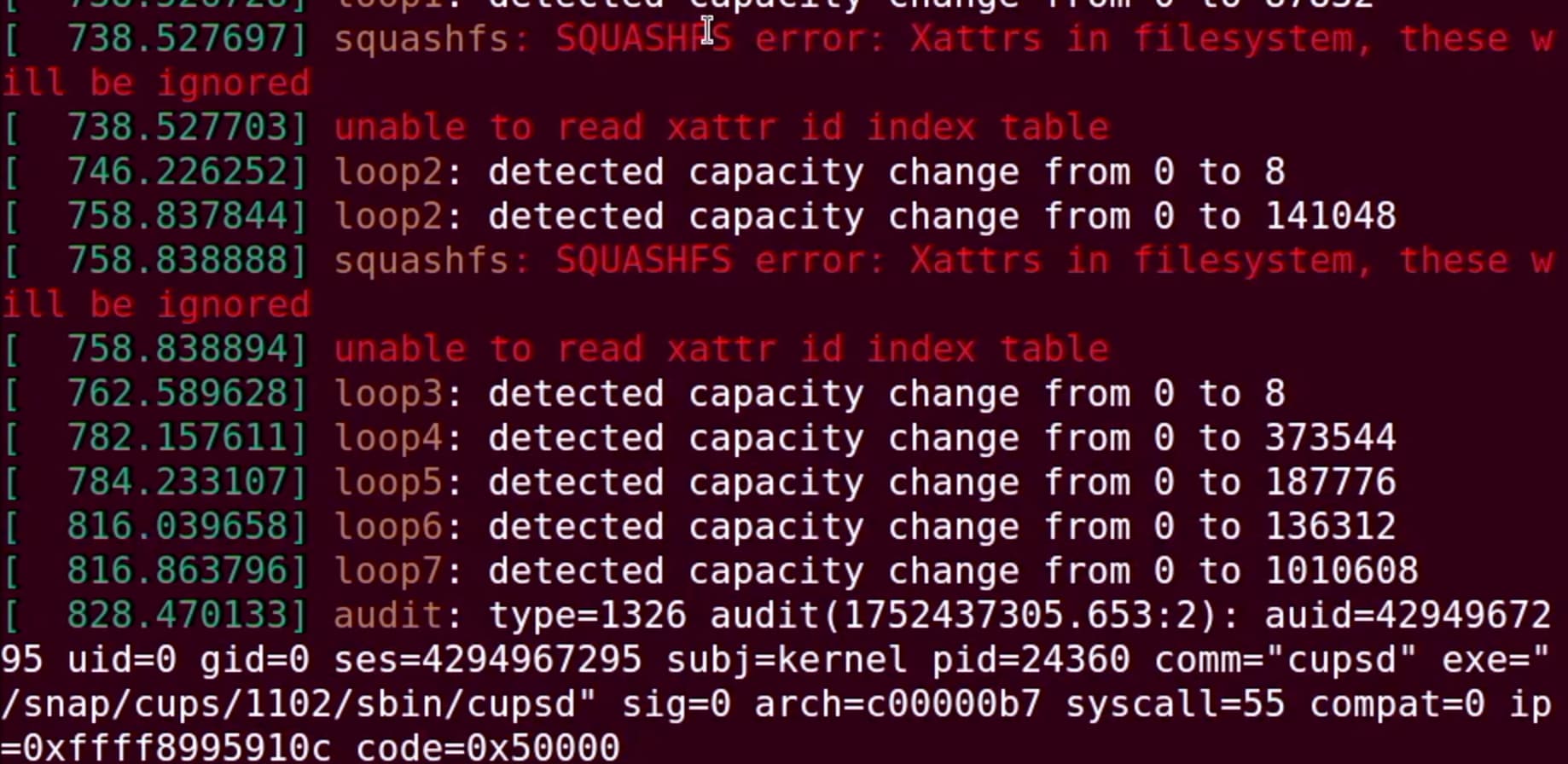

And corresponding dmesg error may indicate something with SELinux and squashfs:
  • These screenshots were captured from YTB channel @JetsonHacks.

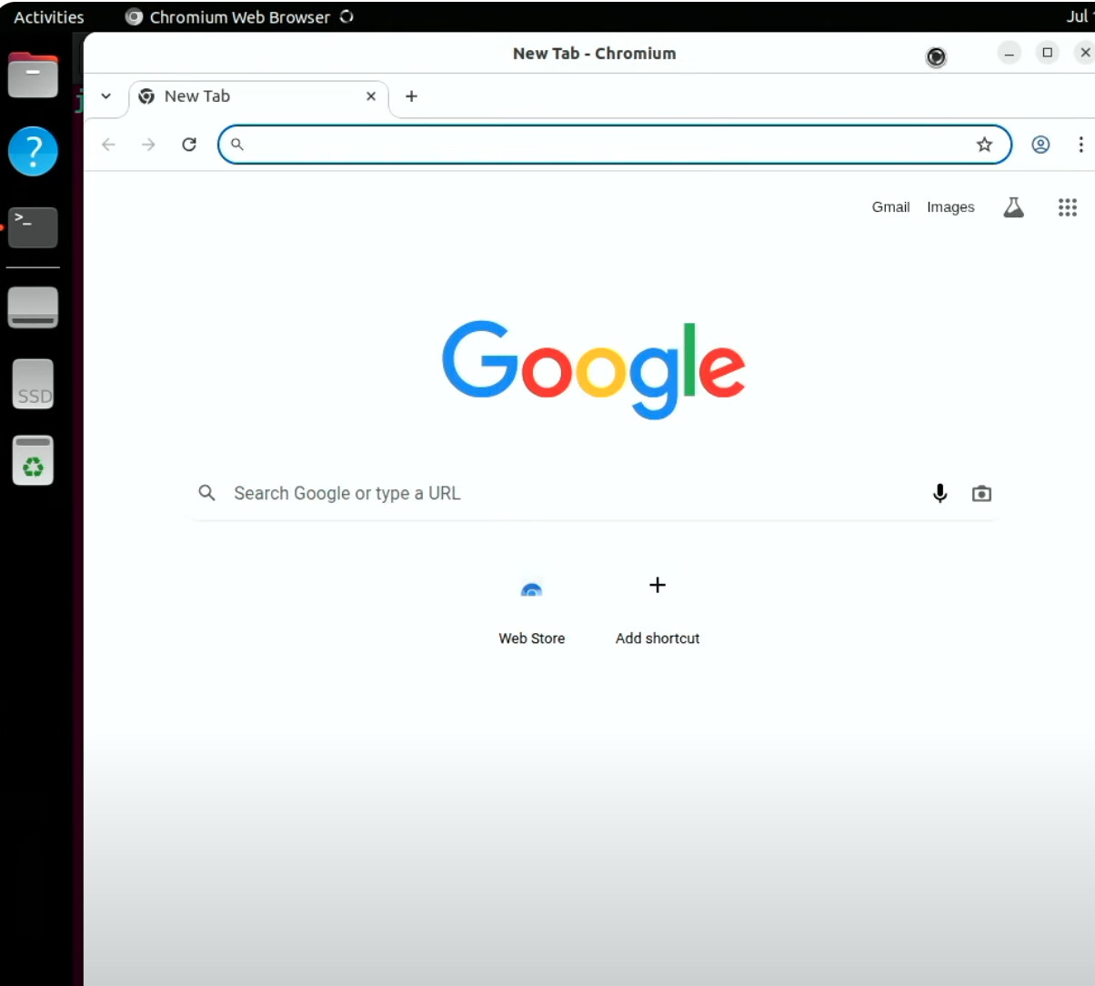

Solutions
  1. Quit using snap, use flatpak to install your software instead.(usually more stable than snap)
According to flatpak, you can run following commands to install flatpak and use flatpak to install browser.
sudo apt-get update
# Install flatpak using APT
sudo apt-get install flatpak
# Plugins
sudo apt install gnome-software-plugin-flatpak
# Use Flatpak install your application
flatpak install flathub org.chromium.Chromium
# Launch your application, or you can launch it from application menu/launch pad
flatpak run org.chromium.Chromium

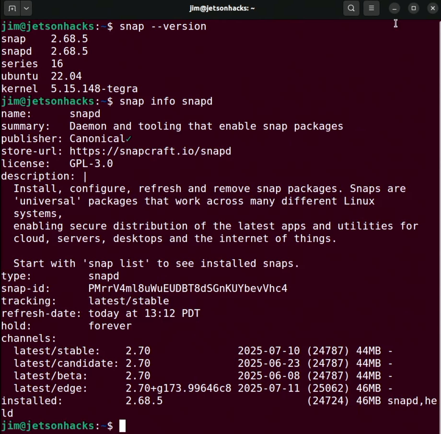

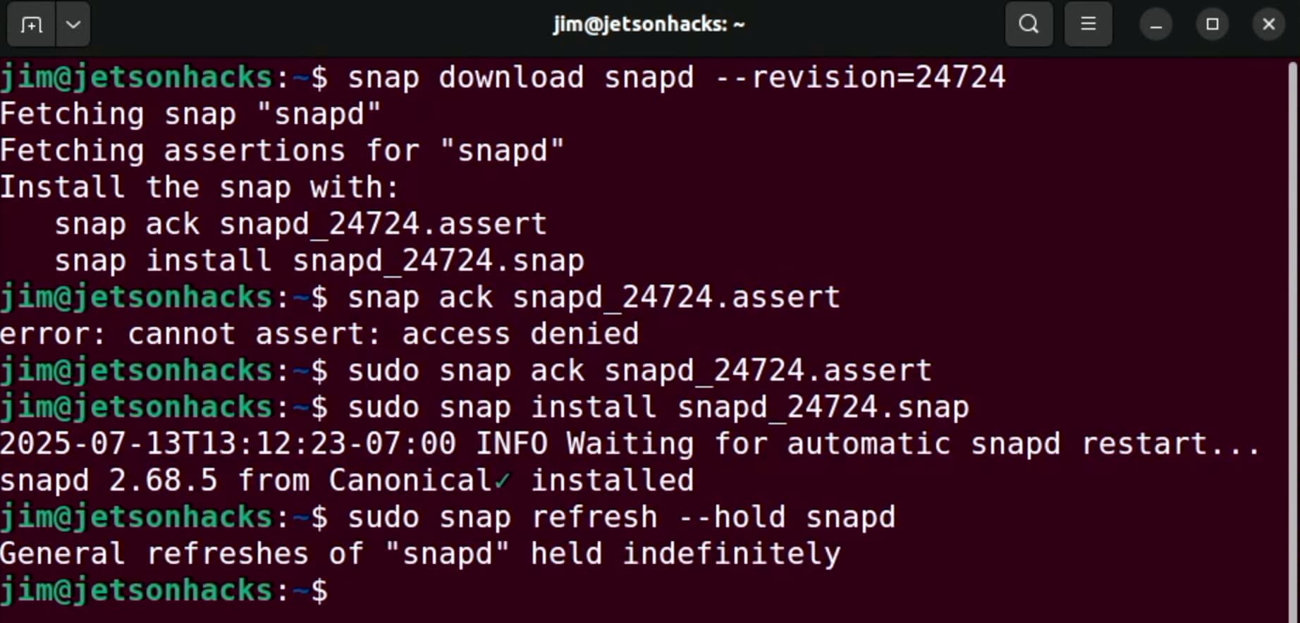

  1. Downgrade snapd.
    The solution can be found on Jetson Forum
You can downgrade your snapd, and your snap application can be launched:

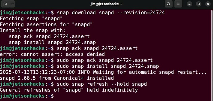

# Search previous version
snap download snapd --revision=24724
# Install previous snapd
snap ack snapd_24724.assert
sudo snap install snapd_24724.snap
# Hold the snapd for further upgrade
sudo snap refresh --hold snapd
After which check your snapd’s version
Then, test the application.
