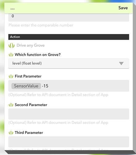

I have the temperature sensor and a ledbar which has 10 individual bars.
If I measure temperature in degree Celsius I get a float of around 17.5 if I forward this float to the led bar all LEDs are always on(for temps above 10°) so it would be cool if I just could make an offset of minus 15 or so…
I tried sensorvalue-15 but it failed. Is this possible? If yes how? Is there a kind of manual which commands can be used?

Hi wio,
I add this feature on test Channel. Invite url: https://ifttt.com/features/redeem?code=7512-043c1082a388ea0fc2603bba547b5b60
Now only enable on Action/Drive any Grove.
How to use:
First character need “=”.
e.g.
={{Ingredient}} -15
Support operators: +, -, *, /, ().
Hope you like it. Any question let me know
