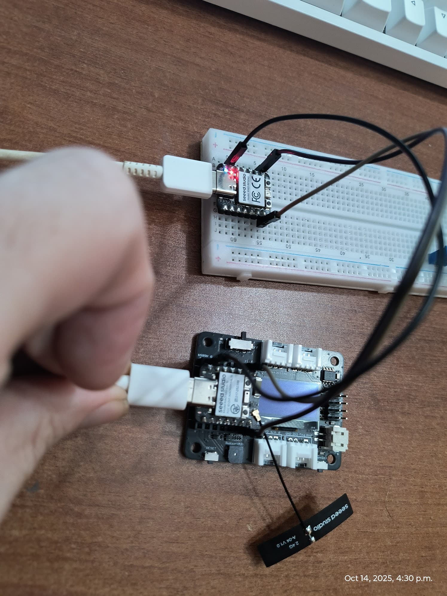

Check out today’s update in the SD_CARD_HW folder, I got the hardware spi working with fat32 cards today.
NOTE: this requires using &uart21, the external pins, as the SD card reader appears to be wired to &spi20
I’m using a rp2040 xiao to read the console

here’s how I’m reading uart21:
