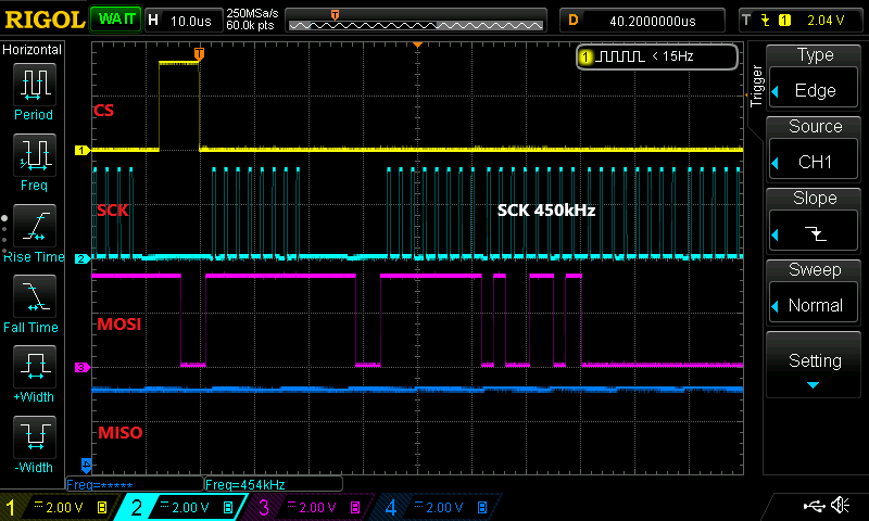

I tested the SD card sample and confirmed it works. Thank you.
Since bit-banging is used, the SCK clock is only 450kHz. Can the clock frequency be increased? Is there any possibility of using hardware SPI?
