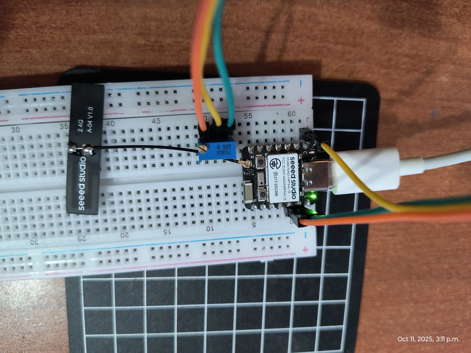

Introducing an updated Sample set for Xiao nRF54L15 / and NRF CONNECT
New tested & Updated ADC sample!
Uses the xiao nrf54l15’s onboard user led to show a potentiometer value via the led blink rate. uses an intuitive inverted scale, where more light = more volts (3300ms delay = 0v, no delay = full 3.3v)
I would have used PWM, but the pin the user led is attached to is not hardware pwm capable.
[00:59:30.421,749] <inf> adc_blink_example: ADC Raw = 3761 (3305 mV)    Blink Delay = 25 ms
