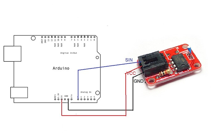

Hi, I’m looking for some help with the Electronic Brick Kit Temperature sensor.
The Docs do not give any clue as to how to connect the module or provide an example sketch.

Hi Geezer,
The following is an example of arduino with temperature sensor.
You can refer to this link. arduino.cc/cgi-bin/yabb2/YaB … 1257341359

OK SQX, many thanks - That works … Sort of…
I’m getting a temperature reading, but it’s nothing like accurate - I wasn’t expecting 3 decimal places and would have been happy with +/- 1 or 2 degrees C. But i’ve placed the sensor (carefully) in ice and I get a reading of 11 degrees :astonished: - just a bit high!
However, at room temperature, it seems to be OK (ish). Looks to me like there is a bit of non-linearity going on here. I also don’t understand the 45/1024 bit of the code - I assume that is some “fiddle factor”. :confused:
