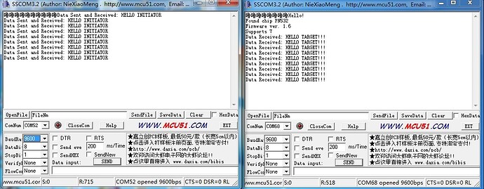

hello, i tested the NFC P2P communication again as the following step:
  1. download the PtoPInitiator.ino and PtoPTarget.ino to 2 arduino , and then plug the NFC shield . i downloaded these demos in Arduino IDE 1.0 , you can download the Library and example attached files.
  2. make the 2 NFC shield close. they communicate well. note the serial baudrate is 9600:
