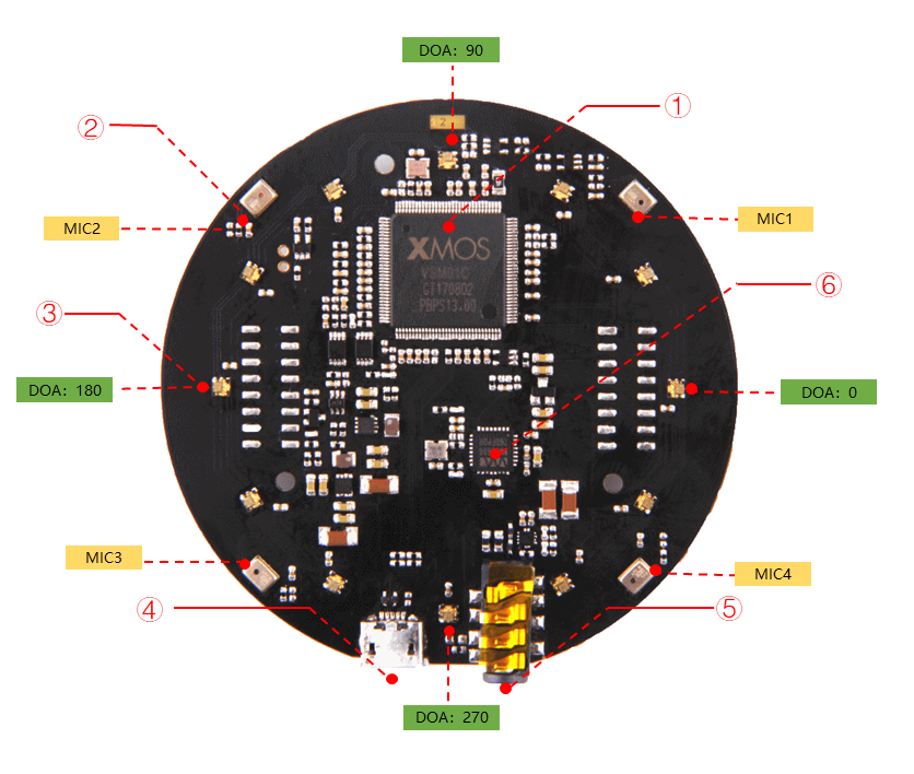

You can connect the speaker to item 5, 3.5mm audio jack. thanks.

2nd may I know the Manufacturer Part Number of the Audio jack you have used
in design of Mic array so to check my application will work or not ??
Hi Sorry, I do not have a good answer for the first question.For the second one, I attached the audio jack spec. thanks.best rgdsBill

Hi
Irfan,
For HP_R, HP_L, The connector and the 3.5mm audio jack are connected together. thanks.

  1. I want to know the cone angle of LED SK6812MINI we have used in MIC
    Array Version 2 so that we can design light guide accordingly.
Hi, 1. The 12 led on respeaker mic array v2.0 is APA102.2. The distance from the center to leds is 27mm.3. the angle between 2 nearby leds is 30 degrees. please let us know if any other issues. Thanksbest rgdsBill
