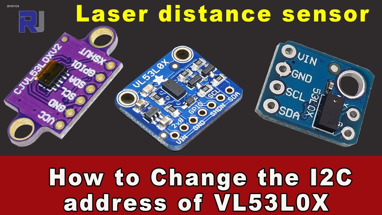

Hi, have you seen this video?
Thanks for the video. Yes, I had seen videos like this one. I indeed have had to change to a different library (instead of Seeed Studio’s library) in order to change the IIC address on my Grove VL53L0X distance sensors. In retrospect, it makes sense that Seeed Studio’s library does not allow users to change the IIC address because it’s made for the Grove VL53L0X sensor, whose XSHUT pin is not wired out (unless the user solders a wire to the board, as shown below).
