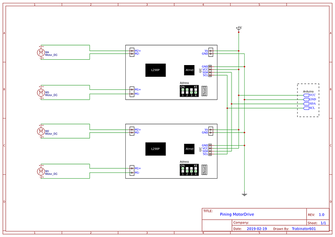

I send you my connection plan.
p.s .: Jumper are not plugged
Hello,
I’ve seen in the schematic you posted that you have used the same power source to supply both the Arduino board and the Motor driver, but the working voltage of 4A Motor is over 6V.
Make sure there are not any problem and do not use USB to supply motor driver or it might be damaged.
Hope the information will help you.
Thanks!
ohhh haha I see. My drawing is wrong. :geek:
The power supply of the motors/board is 12V.
It is a drawing error of mine. :mrgreen:
