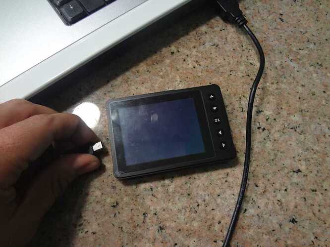

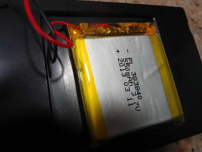

Hello, I have had a v1 which works great for years, just yesterday I got the v3 from Amazon, but the dso does not turn on.

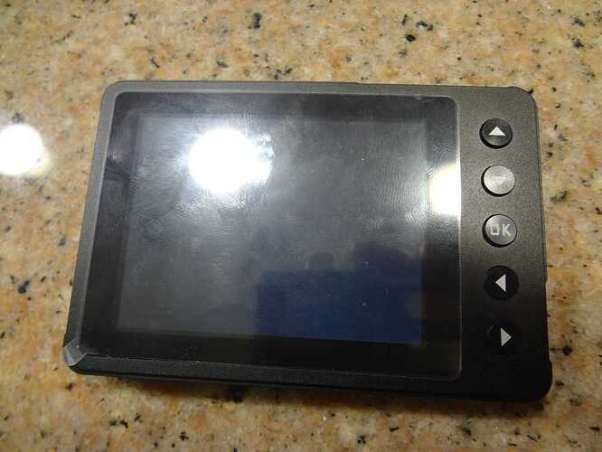

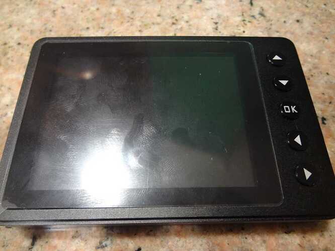

I thought the battery was dead but after letting it sit overnight the next day it still did not turn on, the screen lights up but you get no image.
I have used the latest firmware along with Benf’s also, both have the same problem.

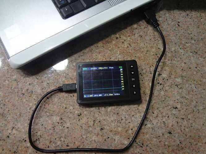

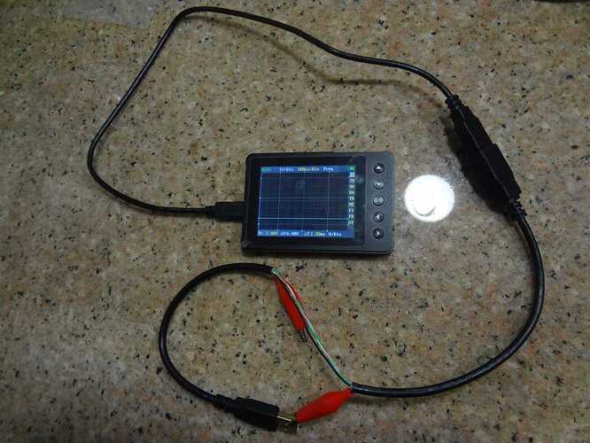

Now here is the weird part, I connected a mini usb to usb cable and attached it to my multimeter to measure current and the battery is charging, but does not turn on if I remove the cable
But if I connect the positive from the usb to the outside (ground) of the usb it turns on. Why?
Want to see if it is maybe something I am overlooking.

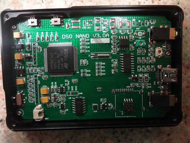

Attached some pictures, hopefully I can fix this without returning it, thanks in advance.
Looks like the battery is too low to drive the circuit. Maybe you should charge for a long time.
If still not working, please check with the following steps:
S1: plug the usb cable, measure the voltage between + and - of the battery pin. -> Should get ~4V, if not, the charging circuit may be broken.
S2: unplug the usb cable, measure the voltage of battery -> if > 3V, your Nano may be out of order.
Hope helpful for you.

Recently, I have the same case. In my case, the connector, between battery and PCB, didn’t connect tightly.
