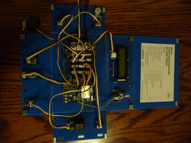

So I recently got a Grove Indoor Environment Kit and I put it together, downloaded the program, ect. But after I booted it up for the first time, about five minuites in it froze up and wouldn’t accept any commands. Any advice?
Hi,
Can you post a photo of your experimental setup.
Did you get any output before it froze up?
Thanks and regards
Yeah, here it is.
It worked fine for a while, maybe 5 - 10 minutes, but after that it refused any more commands and it completely froze up.
I assembled it according to the instructions, and downloaded all the necessary things, but I feel like I missed something.

This example works perfectly with Seeeduino/Arduino.
The technical team confirmed that the issue you are facing is due to I2C hardware problem with the Edison board and it cannot be solved by software.
