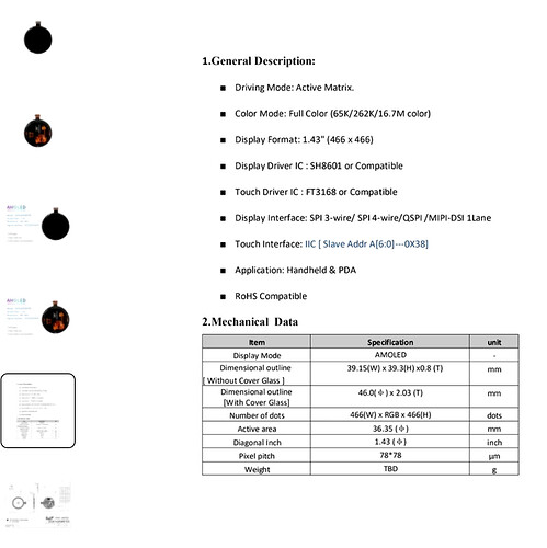

  • screen AMOLED do0143 fmst05 1,43 cala 466*466 SPI QSPI MIPI STM32 ESP32 LVGL

So The Part in the post “AMOLED” is a 3 or 4 wire compatible SPI interface display, Things to note from it’s data sheet (sales page) is the Supply Voltage required (Xiao is a 3.3v MCU) Display Driver chip:SH8601 or compatible and the Touch screen IC Driver required for FT3168 or compatible., Seams pretty standard albeit you will need to read up on what pins connect to which.
