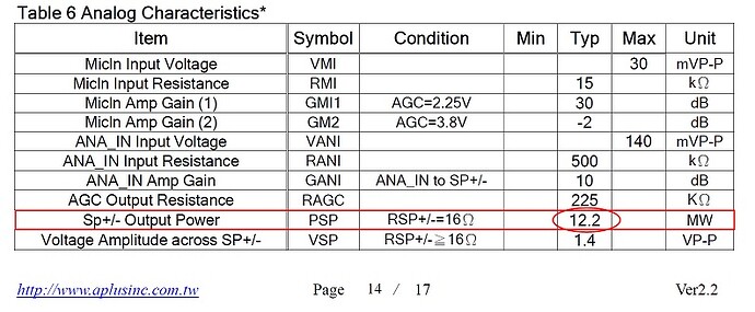

Please refer to the datasheet of APR9600, the maximum power is 12.2mW, speaker less than 8ohm could cause damage to IC.
But you could connect a audio amplifier between the Sounder Recorder and the Speaker. Perhaps below module may help you.

I think the actual power the recorder output will not increase with the load resistance do not change.
The reason is Vp-p of the wave from recorder is fix. (P = U * U / R)
Maybe a power amplifier is good change.
