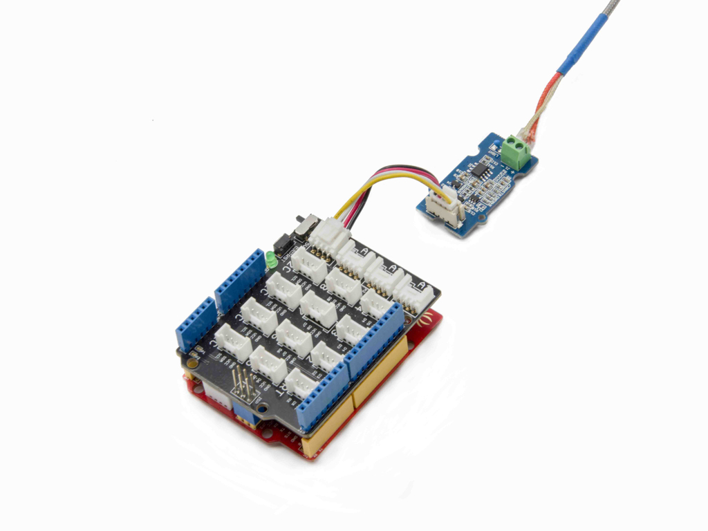

1. For the High temperature sensor, it uses to measure high temperature up to 600 degree C. If you want to use to measure the temperature inside card, you can use normal temperature sensor.
You can connect the sensor to A0 port of base shield, which includes a0 and a1 pins. If you do not have base shield, you can follow below connection.
Seeeduino Grove-High Temperature Sensor
GND Black
5V Red
A1 White
A0 Yellow
