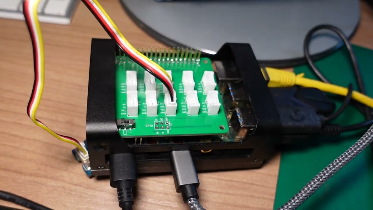

I’ve been beavering away at my writing Grove drivers for LabVIEW, but I also wanted a functional hat for my Radxa X4… Yesterday I cracked the OLED and today I got my hat PCB in for testing…
Today is a good day…

Which Grove HAT are you using in the video?
One I designed myself, based on the Pico grove interface. Can share the kicad project if there’s interest

I’m gonna open-source everything as soon as I reach a point where it is organised. I’ll make my money doing training…
If anyone wants it sooner just DM me.
Just got the UARTs tested, only need to test SPI and all hardware is done…
I’ve done about 10 I2C drivers so far, loads of digital and analog boards too.
We have improvements to the Pico firmware planned … pico-w soon, which will rock!! and I’d like some sort of triggered acquire and generate.
