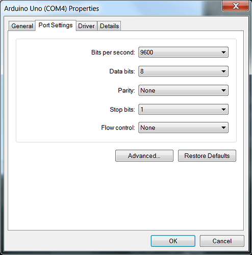

I tried changing it with SSCOM3.2, but it’s showing me “) )I!!$”, even if i select the right settings in the interface.
I attached a screenshot.

  1. Connected to SSCOM, after reset hardware. (9600-8-1) See image
  2. First Command ‘A’ → A
  3. AT → OK
  4. AT+IPR=9600 → OK
  5. All is working. Happy

Not sure. Was almost giving up. But one last try in 9600 baudrate, because I checked COM4 port in Windows. (Not sure if this was the problem).
