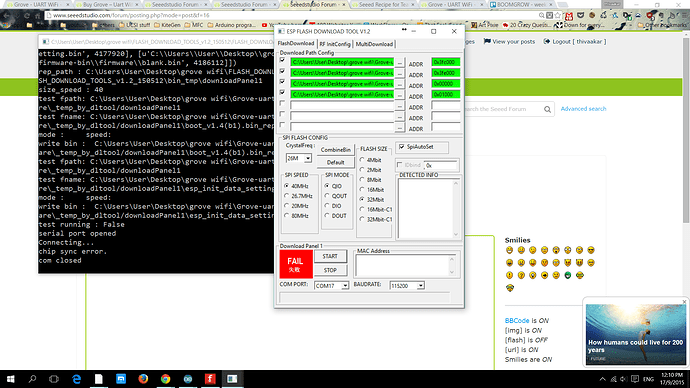

I’ve recently purchased the grove ESP8266.
I followed the guidelines to flash the firmware but i failed.
kindly refer to the image to understand what am i facing.
Please advise what should i do. ![]()

Hi,
the “chip sync error” may happened sometime, I think you can retry follow the steps blow:
1, check your Rx and Tx signal connection: Grove Pin0 -> UART Bee Tx; Grove Pin1 -> UART Bee Rx;
2, hold the button on the Grove - UART Wifi module until the red LED lights on
3, push the “Start” button again on you computer
if it shows “chip sync error” again, you can retry step 2 ~ 3
