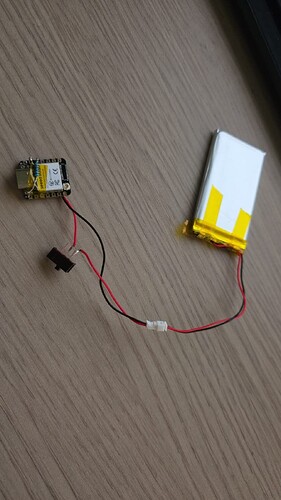

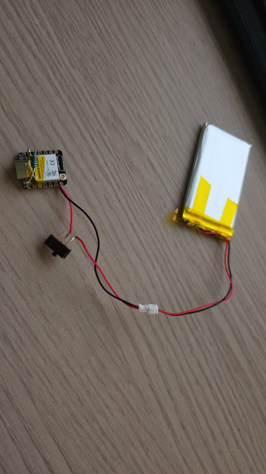

I have this:
The resistor is part of the voltage divider for a sensor. The battery is a 1100Mah Lipo.
What I’ve noticed… it charges (flashing led) until it’s full. But once full, it stops charging, never to resume again. Also flickig the switch while in operation on USB, will cause a crash. Removing the usb while in operation, same thing.
Check which PMIC your board uses, if any.
If it’s bare TP4056, it won’t support auto power switching.
Try a dev board with proper PMIC (like IP5306 or BQ24074).
