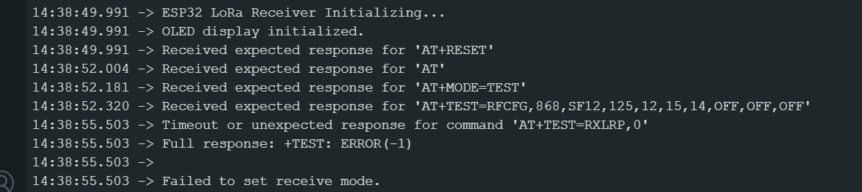

Can anyone shed some light on why the Wio-E5 refuses to enter continuous reception? This is the error from the Arduino IDE Serial console when trying to setup reception
Unfortunately I don’t have the source code that caused that error but I will try to re-create it.
Thanks
Just to close this, I figured out the problem, as I typed the original post I thought the command didn’t seem right so I started looking through the AT command set for the wio-E5, I couldn’t find the exact command the AI wanted to use but found another
I pasted the above image into the AI prompt and it apologised and re-did the code using that new command and now it works great, no packets missed :slight_smile: Just goes to show, AI is good but it does make mistakes
