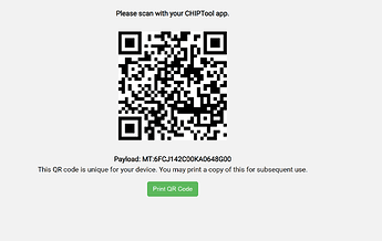

I: 264 [SVR]SetupQRCode: [MT:6FCJ142C00KA0648G00]
I: 269 [SVR]Copy/paste the below URL in a browser to see the QR Code:
I: 275 [SVR]https://project-chip.github.io/connectedhomeip/qrcode.html?data=MT%3A6FCJ142C00KA0648G00
I: 284 [SVR]Manual pairing code: [34970112332]
E: 288 [DL]Long dispatch time: 247 ms, for event type 2
I: 294 [DL]CHIPoBLE advertising started
I: 297 [DL]NFC Tag emulation started
uart:~$ I: 30297 [DL]CHIPoBLE advertising mode changed to slow
I: 30303 [DL]CHIPoBLE advertising started
and the QR code
Alexa, Finds it without issue.

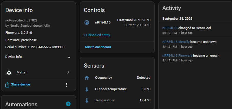

I tried to build the xiao_nrf54l15 Thermostat sample. OK for NCS 3.0.2, but not 3.1.x.
Testing it with Home Assistant
