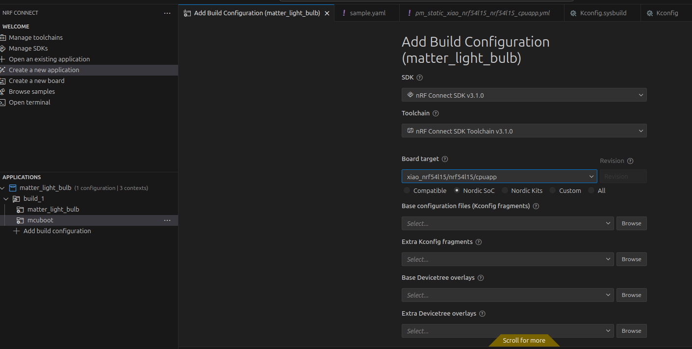

Hi,
I bought a XIAO nRF54L15 board to use it for Matter samples (Matter light)
I am facing an issue building the firmware using nRF SDK 3.0.2.
Could you provide me a tutorial for building Matter samples for XIAO nRF54L15 board?
It will help a lot of people too.
Build config
Error
build_nRF54_error.zip (1,6 Ko)
Regards
Ludovic

I have add 4 files in my project:
  • pm_static_xiao_nrf54l15_nrf54l15_cpuapp.yml
  • sysbuild/mcuboot/boards/xiao_nrf54l15_nrf54l15_cpuapp.conf
  • sysbuild/mcuboot/boards/xiao_nrf54l15_nrf54l15_cpuapp.overlay
  • boards/xiao_nrf54l15_nrf54l15_cpuapp.overlay
So now I have an issue with TEMP_NRF5_MPSL.
Do you know why?
