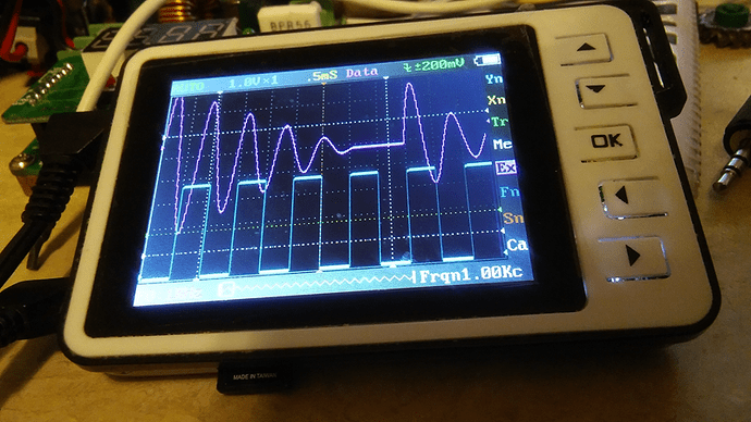

I was curious about official minidso DS201 V4.30. I could not find a .dfu build for old Hw V1/V2 DSO201 with lcd 7781 so ended up porting 9341 to run on my DSO Nano Hw V2.
It seems to runs ok.

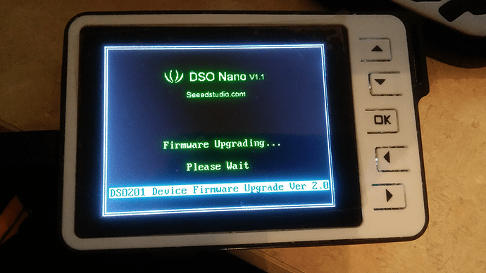

The attached zip has the .dfu, Flash it using DfuSe Demonstration. Remember only for DS201 with lcd 7781.
