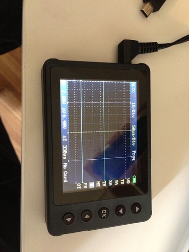

Here, anybody to spot SD card slot in my v3 will get a free beer.

I can’t even install it, i’ve got black and white vertical lines, and no boot. Had to go back to 4.11 or 4.20, but both of them still have the issues i’m trying to get rid of.
