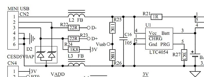

opened my dso nano… saw that there’s a burned diode, L3. tried to put a jumper, then it works now.
do somebody here know what does L3 do? And what cause it to burned.
would it not cause any problem if i just put jumper instead of replacing L3? will it still function properly?
Just notice that my dso nano won’t with battery only. Have to plug usb… It also gets hot when plug in.
