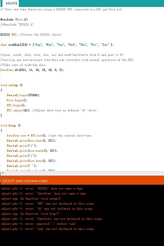

I’ve just hooked up my Seeduino Stalker and the sample code on the wiki works, but the examples in the “DS3231 library for arduino 1.0” don’t work. I’m using Arduino 1.0.1 on a Mac.
Here are the errors when trying to upload the adjust example:
adjust.pde:-1: error: ‘DS3231’ does not name a type
adjust.pde:-1: error: ‘DateTime’ does not name a type
adjust.cpp: In function ‘void setup()’:
adjust.pde:-1: error: ‘RTC’ was not declared in this scope
adjust.pde:-1: error: ‘dt’ was not declared in this scope
adjust.cpp: In function ‘void loop()’:
adjust.pde:-1: error: ‘DateTime’ was not declared in this scope
adjust.pde:-1: error: expected `;’ before ‘now’
adjust.pde:-1: error: ‘now’ was not declared in this scope
Hi,Dear
According to your errors,you need to check that whether your libraries contain DS3231 files.
And if you hide"#include “DS3231.h” ",it’ll occur the same errors,just like the following picture shows
