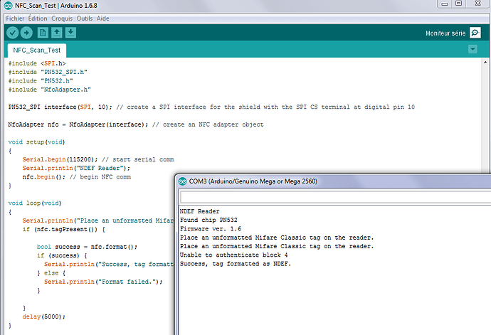

It’s work when i use the program of the website like…
For exemple, Read a tag of my Smarthone for look my UID for example…
Look :
For formatted a tag… it’s work !
HERE i I Follow the instructions of the website “NFC Shield V2.0 | Seeed Studio Wiki”

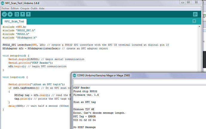

now, i want to test the NDEF Libraby who they give…

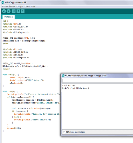

When i want test a example NDEF Library… FOR TRY
Example, “Write a TAG”
I have a problem, on my screen, there’#if 0

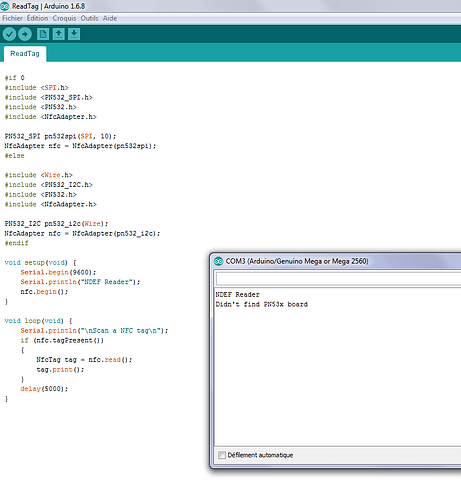

or i test other example, Read a tag… same problem why ???
i want to read the tag… or write… WHY PN53X Board ??

Hi,
NFC Shield works only on SPI Communication please change the following line of code to solve your issue.
#if 1 in the ReadTag and WriteTag program.
Thanks and Regards
Yes now it’s work, thanks ! ^^
