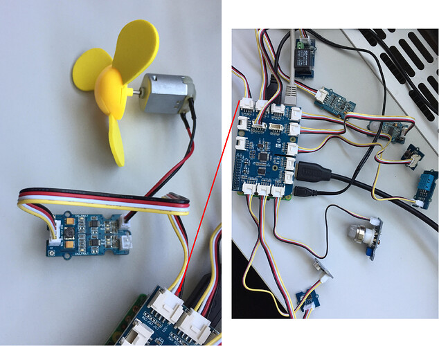

Hi Nace,
please help take a picture of whole setup. we can see if we can simulate the issue. thanks.
Bill

[attachment=0]grove_setup_f.png[/attachment]

Any progress on this? We’ve done some research and tried out some methods, but we are still unable to start the motor using GrovePi C# library.
I’ve successfully driven the Grove - Mini I2C Motor Driver, and there’s no same issue reported for this, so I can temporarily conclude that your issue isn’t a common one.
Could you share more informations about your research? Have you tried other I2C Groves e.g. Grove - OLED Display 0.96" ?
From the error message
What I get from the message is, the Grove - Mini I2C Motor Driver may be damaged. Have you tried to drive this Grove via an Arduino board? Or grab some board that can do I2C scan, does the Grove - Mini I2C Motor Driver respond to any I2C communications?
