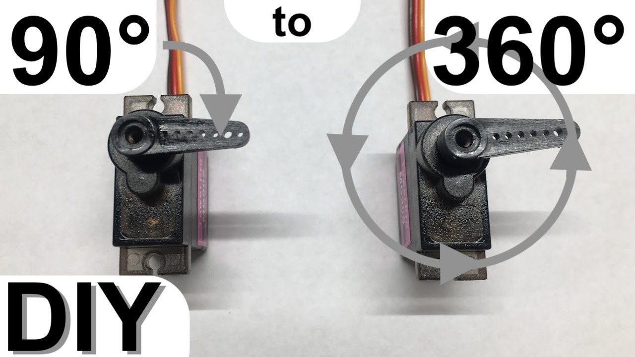

Thanks for the reply, so are you saying besides the fact that we can set a “home” signal with some kind of limit switch, there’s not much we could do? I am only realistically looking for setting 360 or max 720 degreee rotation, is there anything I could do?
Thank you
if you remove the stop but do not disable the pot you may be able to program it… just an idea… not sure
you may could break out the pot to a separate control feedback loop
Stepper motor or Encoder… Pretty much it for other options.
either is a good choice too. just depends on the torque and other stuff which way to go and the $$ cheese for said method as well.
