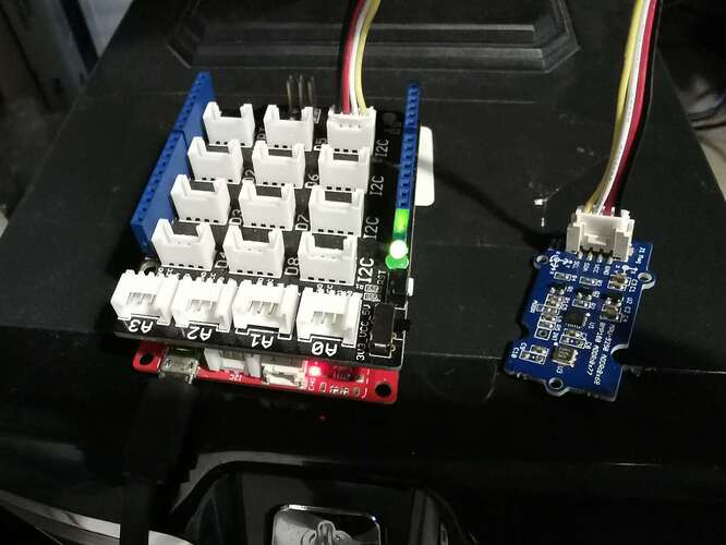

Did you connect the Grove-IMU 9DOF to Seeeduino LoRaWAN directly,or use wrong i2c interface at the base shield ? You should connect the Grove-IMU 9DOF to the base shield with right i2c interface.

You need a Grove base shield. Hardware connect picture like this.
