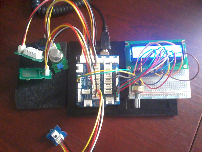

good day. I have developed a device using arduino uno. this device consists of several sensors. gives the values of the sensors to the computer. I’ve done it but for a single device, multiple devices to a computer that will use and how to take data from all the devices you need to install a communications network which need to use auxiliary equipment. max 100 and 300 meters between devices may be computers. I want to find solutions to the wired and wireless. I would be glad if you help. good work.
