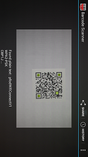

When your LinkIt ONE is started in config mode (the setup digital input is grounded) then it automatically tries to connect to the coded temporary network. The network SSID is always pfodWifiConfigV1, security is WPA2-PSK and the password is unique to your LinkIt ONE.
You generate the password and the network details (using the java program provided) as a QR code and attach it to your card.

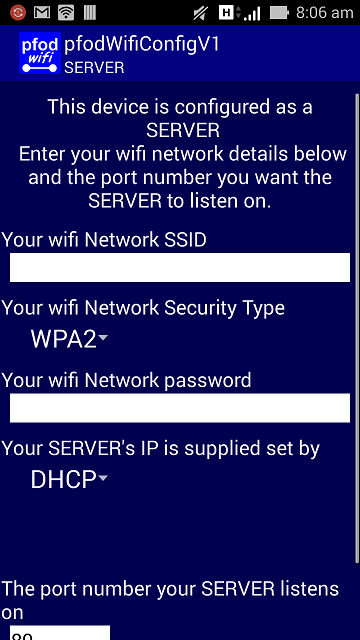

The user scans this QR code and uses the data to configure a temporary Access point on their mobile. They can then connect to your card, via the temporary network, and send the configuration command with their network details. These are saved in EEPROM.
Then when they reboot the LinkIt ONE it will connect to their real network.
Here are some screen shots from the android app
