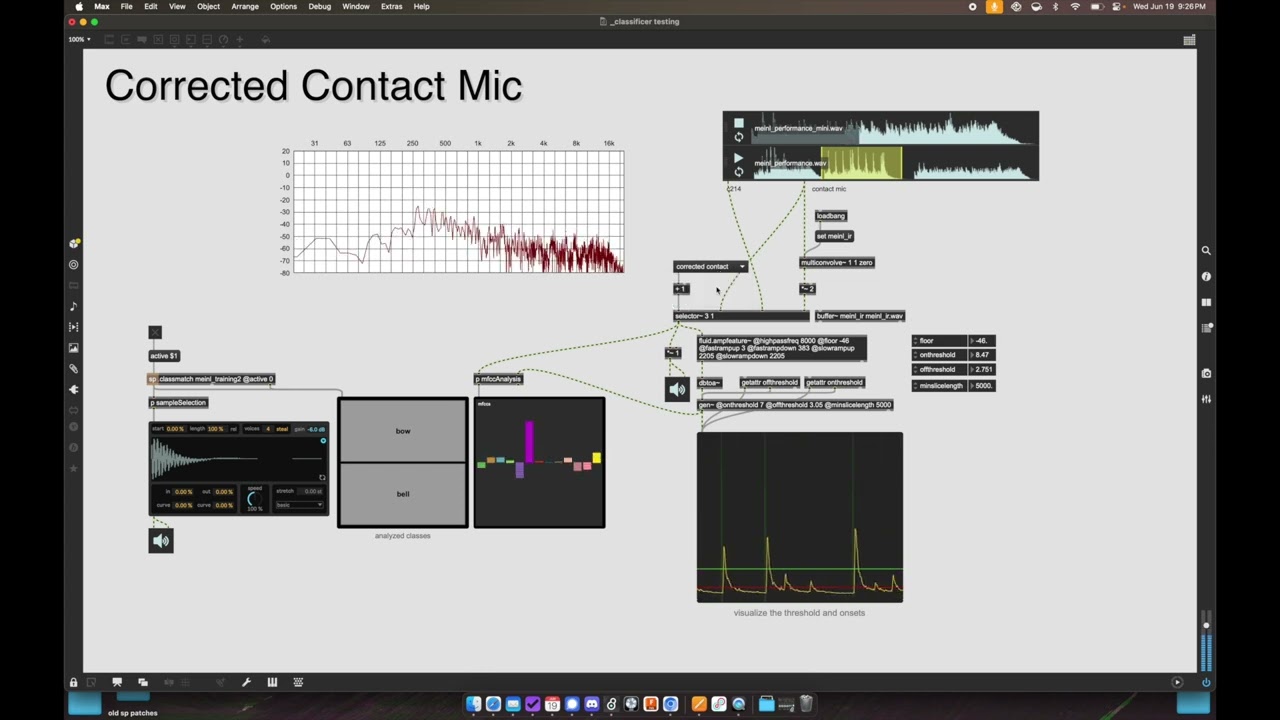

Every time the cymbal is hit it triggers a burst of noise, and the movement of the cymbal controls a filter and a phasor on the noise.
Less relevant to the ESP32 code, but this is a proof-of-concept test of the audio from the contact microphone. So I’m comparing a real/good microphone picking up the acoustic sound of the cymbal vs the contact microphone in a less-than-ideal position on the cymbal (typically a really bad idea). Then doing some impulse response microphone correction to “compensate” for the difference between the two. Then finally doing some classification to determine (just from the audio analysis) whether the cymbal is being struck on the body, or the bell area:
