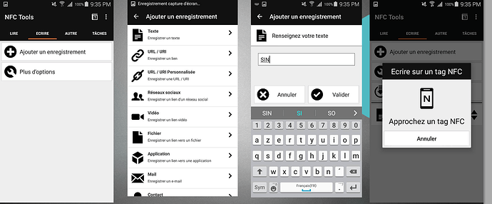

Look screen :
I use “NFC Tool” on Play store !
We can write and Read a tag…
Look.
It’s an application FR
For example, " SIN" this is the TAG writter NFC
I want that NFC shield decode my message and Read…

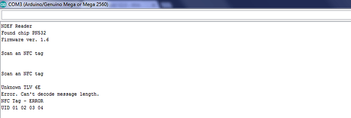

I use this code
[code]#include <SPI.h>
#include “PN532_SPI.h”
#include “PN532.h”
#include “NfcAdapter.h”
PN532_SPI interface(SPI, 10); // create a SPI interface for the shield with the SPI CS terminal at digital pin 10
NfcAdapter nfc = NfcAdapter(interface); // create an NFC adapter object
void setup(void)
Serial.begin(115200); // start serial comm
Serial.println(“NDEF Reader”);
nfc.begin(); // begin NFC comm
void loop(void)
Serial.println(“\nScan an NFC tag\n”);
if (nfc.tagPresent()) // Do an NFC scan to see if an NFC tag is present
NfcTag tag = nfc.read(); // read the NFC tag
if(tag.hasNdefMessage())
NdefMessage message = tag.getNdefMessage();
for(int i=0;i<message.getRecordCount();i++)
NdefRecord record = message.getRecord(i);
int payloadLength = record.getPayloadLength();
byte payload[payloadLength];
record.getPayload(payload);
Serial.write(payload,payloadLength);
delay(500); // wait half a second (500ms) before scanning again (you may increment or decrement the wait time)
} [/code]

Hello,
Could you please post more information about the tag that is being read. Please check if it is compatible with NFC Shield (i.e PN532 chip datasheet provides the NFC standards that are supported)

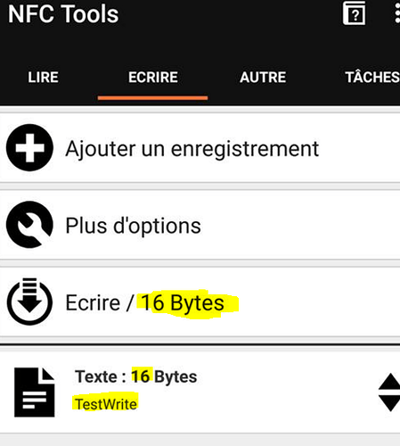

with the application “NFC TOOL” i’ll write “TestWrite” “16bytes”
and write is occured…
Look : here this is my text on my application
i put the smartphone on the antenna, and he can read

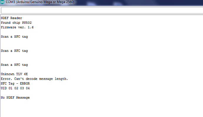

But when i want to use a simple program to read…
[code]
#if 1
#include <SPI.h>
#include <PN532_SPI.h>
#include <PN532.h>
#include <NfcAdapter.h>
PN532_SPI pn532spi(SPI, 10);
NfcAdapter nfc = NfcAdapter(pn532spi);
#else
#include <Wire.h>
#include <PN532_I2C.h>
#include <PN532.h>
PN532_I2C pn532_i2c(Wire);
NfcAdapter nfc = NfcAdapter(pn532_i2c);
#endif
void setup(void) {
Serial.begin(9600);
nfc.begin();
void loop(void) {
Serial.println(“\nScan a NFC tag\n”);
tag.print();
delay(5000);
}[/code]
but he can’t read, why ??
i don’t understand, i want that he read…
pls help???
