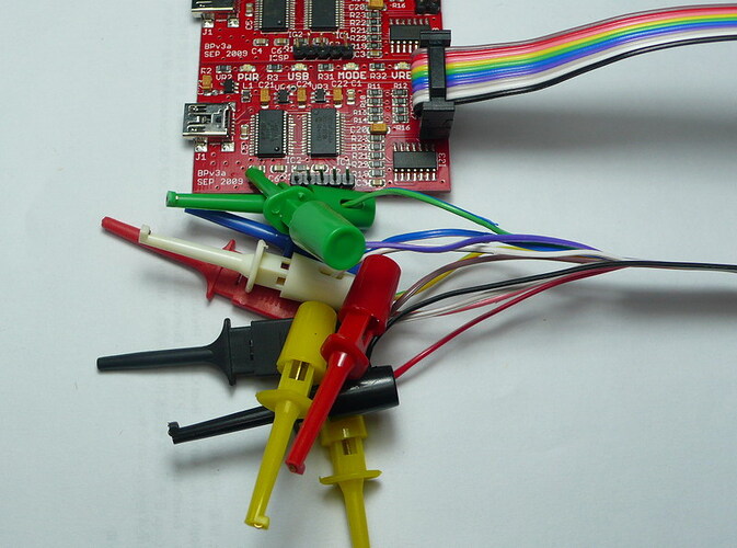

Does anyone have a color to pin map? I am assuming I can not be the first one to need such a list.
Plug as picture shows.
color defined as(from top to bottom):
GND–>GND
+3.3–>+3.3
+5V–>+5V
ADC–>ADC
Vpu–>Vpu
AUX–>AUX
CLK–>CLK
MOSI–>MOSI
CS–>CS
MISO–>MISO
