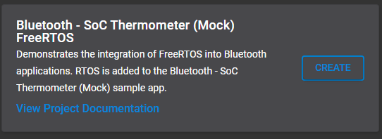

@mattmagic - Easy in Simplicity Studio but a little harder in Arduino. I haven’t tried PIO, but can use VSCode for development and debugging of (Simplicity Studio based) XIAO MG24 code.
For Simplicity Studio.
For the LSM based (and other) device I just write my own code based on the sample libraries if the library isn’t available for the BLE stack you are using.
For OTA, it’s included with the examples in Simplicity Studio so easy to implement. Just create the example (eg Bluetooth SOC Thermometer (Mock)) and run the SiConnect app (phone - send gbl there). Connect and Select OTA, upload the gbl file.
