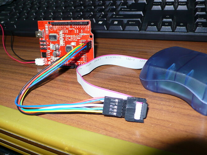

I bought a AVRISP programmer, but the problem is I only have slot load drives so the 3" CD you sent with it can’t be used. I’ve tried and tried AVR Studio and no luck, any ideas???
Hi
Sorry for delay.
Please download the Driver for windows from:
http://www.seeedstudio.com/depot/atmel-avrisp-stk500-usb-isp-programmer-p-207.html
Or download the pl-2303HX driver for your OS .
The target board should be electrified.
And connect with the AVR Studio4.
Thanks
Albert
Thanks, though I had already got it working, it might be good to place a link right on the product page though.
