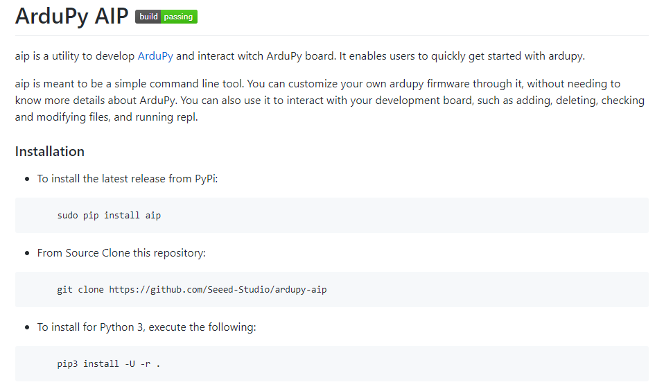

Wait… I have found the ardupy-aip repo in github. It seems that it’s not a released package.
Install with
pip install aip
git clone https://github.com/Seeed-Studio/ardupy-aip
pip3 install -U -r .
Next week, before users receive the Wio terminal, we’ll push it to Pypi and you can experience it first with the steps above CI. @ONLYA
Great thanks. I have installed the aip now via pip. Now just waiting for my package and a detailed official ardupy-aip and wireless connectivity documentation.
