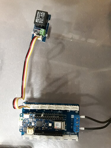

I was planning to use an Arduino MKR WiFi 1010 + MKR Grove Carrier + Grove-Relay (SKU 103020005) as a solution for some remote control operations, but reading the specifications of the relay activation of the Grove-Relay and the DC Current per I/O Pin(7 mA) of the Arduino MKR WiFi 1010, it seems that the last one is not capable for such an activation. Can someone give another Grove solution in the market for 250VAC operation?

as I said, the Grove-relay module connected to the ‘Arduino MKR Connector Carrier + Arduino MKR WiFi 1010’ set does not work. When activating a digital output the led of the Grove-relay module lights so dim and the relay doesn’t turn on.

as comented before, whith the hardware configuration of the picture with your code the led lights very weakly and the relay does not turn on.

I’ve just received a new Grove-relay and it works perfectly… everything was fine from the very begining except for the Grove-relay wich was defective.
