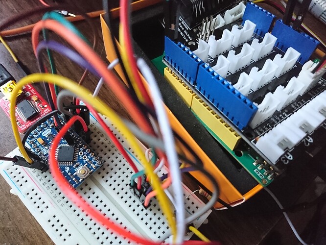

I’ve rigged up an arduino mini-pro as a slave to a linkit one; I needed more interrupts for the data logger I’ve been building. I’ve got the slave sending anemometer data to the master via wire() & I2C, the problem I’m having is that only some of the data is getting sent.
I’ve attempted looping over the charArray, and the result at the master end and so far no luck. For illustration purposes I’ve removed the code that handles getting the anemometer data and hard-coded a string; the same format string construct before sending.
I send the string “S123.09D232.42” from slave to master but only “S123.09D” is received. I’ve tried setting the requested data to 32 bytes to no avail. and I’m not sure what exactly I’ve done incorrectly.
I appreciate your insight.
[attachment=0]DSC_0800.JPG[/attachment]
[attachment=1]DSC_0799.JPG[/attachment]
[attachment=2]DSC_0798.JPG[/attachment]
Byron
