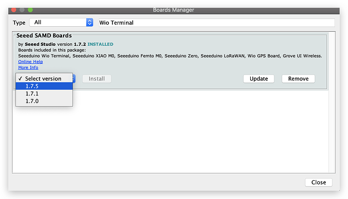

Where is the 1.7.4 version? My Arduino IDE only goes up to 1.7.2 and a web search didn’t come up with anything.
Thanks
Completely quit Arduino IDE and try again pls.
