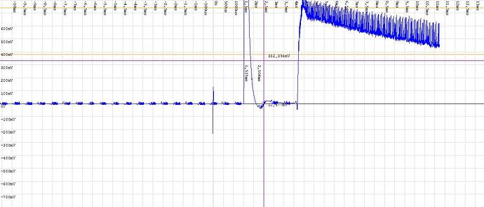

However with this file not everything is shown in the screen:
FILE008.zip (16.9 KB)
I’m glad that you find this application useful (I haven’t worked on it in some time!)
It can zoom out both horizontally and vertically, so you should be able to change the view to see what you need (assuming it was actually captured by the device).
